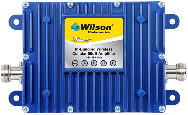

| In-Building 800 MHz Wireless 50dB Amplifier
Works on CDMA, GSM & 3G networks. Requires outdoor antenna, indoor antenna and cables.
| Frequency Range |
824-849 MHz/
869-894MHz |
| Amplifier Gain |
50dB max |
| Max Output Power |
35dBm |
| Max RF |
30dBm (Uplink & Downlink) |
| Noise Figure |
3dB |
| Gain Flatness |
+/- 2.5dB |
| Isolation |
> 90dB (uplink/ downlink) |
| Input impedance |
50Ω |
| Size(inches) |
5.6"x3.6"x1.7" |
| Weight |
1.5lb |
| Cable/ Connector |
N-Female (cable sold separately) |
| Power Supply |
120 VAC/ 3 A max (includes AC/DC power brick to convert to 6VDC) |
- NB. Requires a 40ft separation between the outdoor antenna and indoor antenna to prevent oscillations

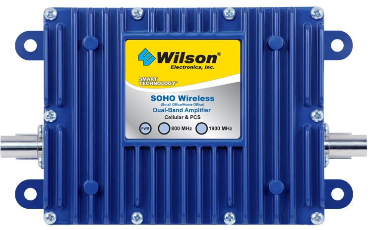

In-Building Dualband 800/1900 MHz Wireless 50dB Amplifier
| Frequency Range |
824-894 MHz/
1850-1990 MHz (Cellular & PCS band) |
| Amplifier Gain |
50dB max |
| Max Output Power |
30dBm |
| Max RF |
30dBm Uplink &
10dBm
Downlink |
| Noise Figure |
3dB @ 800MHz,
4dB @ 1900MHz |
| Gain Flatness |
+/- 2.5dB |
| Isolation |
| Receiver Sensitivity |
-110 dBm for CDMA @ 1% Frame-Error Rate (FER) |
| Input impedance |
50Ω |
| Size(inches) |
5.6"x3.6"x1.7" |
| Weight |
1.5lb |
| Cable/ Connector |
FME-Male (cable sold separately) Includes 2 N-Female/FME-Female connectors |
| Power Supply |
- NB. Requires a 25ft separation between the outdoor antenna and indoor antenna to prevent oscillations

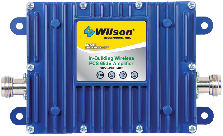

In-Building 1900 MHz (PCS) Wireless 60/65dB Amplifier
| Frequency Range |
1850-1990 MHz
| Amplifier Gain |
P/N: 801306 60dB max
P/N: 801365 65dB max |
| Max Output Power |
33dBm |
| Max RF |
25dBm (Uplink & Downlink) |
| Noise Figure |
4dB nominal |
| Gain Flatness |
+/- 4dB |
| Isolation |
| Input impedance |
50Ω |
| Size(inches) |
5.6"x3.6"x1.7" |
| Weight |
1.5lb |
| Cable/ Connector |
| Power Supply |
Input: 100-240 V AC 50/60 Hz 0.6 A / Output: 6 V DC 3 A |
- NB. Requires a 50-75ft separation between the outdoor antenna and indoor antenna to prevent oscillations
Buy 801306
Buy 801365
801306 Manual
801365 Manual
Drawings |

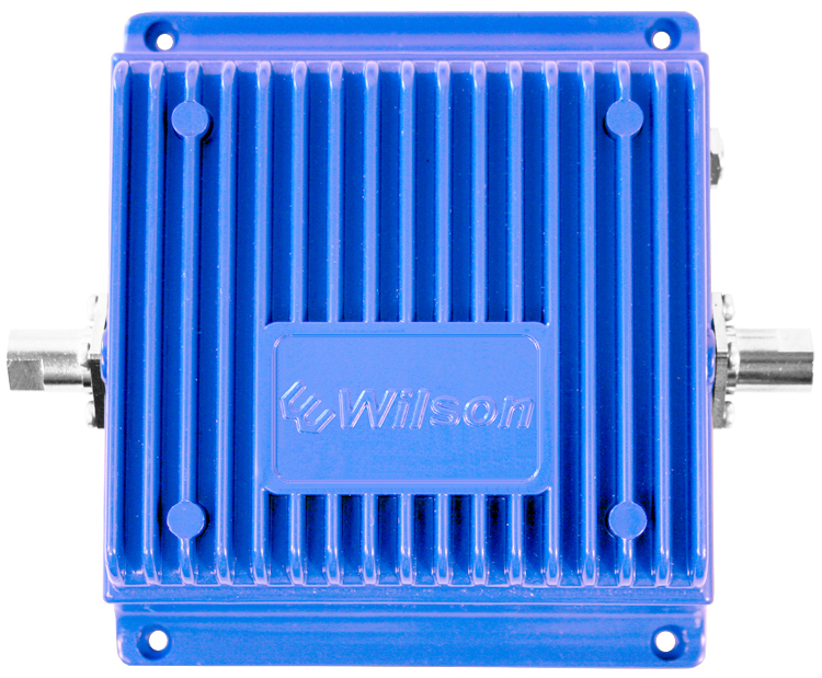

| Direct-Attach Amplifiers (for buildings & vehicles) |
Direct Connect Dual-Band 800/1900MHz Amplifier
Works on CDMA, GSM & 3G networks. Can use in vehicles, boats and in-building
| Frequency Range |
824-894 MHz/
1850-1990 MHz |
| Amplifier Gain |
10dB @ 800MHz
14dB @ 1900MHz |
| Max Output Power |
3 Watts |
| Max RF |
35dBm Uplink &
15dBm Downlink |
| Noise Figure |
3.5dB nominal |
| Gain Flatness |
+/- 2dB |
| Isolation |
| Input impedance |
50Ω |
| Size(inches) |
5"x3.5"x1.2" |
| Weight |
1.03lb |
| Cable/ Connector |
FME-Male (cable sold separately) |
| Power Supply |
12V, 0.5-1.5A max |
Buy 811201
Install Guide
12V AC/DC
Drawings |

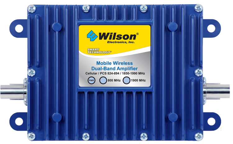

| Wireless Mobile Amplifiers (for Vehicles) |
Dual-Band 800/1900MHz Mobile Amplifier
| Frequency Range |
824-894 MHz/
1850-1990 MHz |
| Amplifier Gain |
40dB @ 800MHz
45dB @ 1900MHz |
| Max Output Power |
35dBm |
| Max RF |
35dBm Uplink &
10dBm Downlink |
| Noise Figure |
3dB nominal |
| Gain Flatness |
+/- 2dB |
| Isolation |
| Input impedance |
50Ω |
| Size(inches) |
4.5"x3.5"x1.25" |
| Weight |
1.03lb |
| Cable/ Connector |
| Power Supply |
6V, 3A max |
Buy 801201
Install Guide
6V AC/DC
Drawings |
